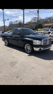

I just dropped mine, 3/5, with 305/40/22 srt10’s. And have no issues with rubbing at all.
