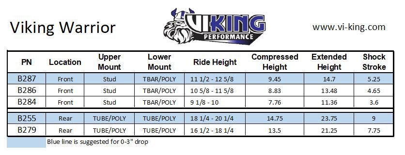

MCMLXIX
Jan 16, 2020
259
230
Las Vegas
5.7 HEMI R/T
Viking offers variations for truck lower than 2/4... If your ride height isn't in the middle of the shock travel, the valving won't be effective no matter what number you set the compression and rebound ...VIKING PN.JPG
