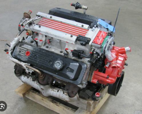

The next generation engine, the LT1 was the opposite. It only had a fixed, short runner intake. Much better high RPM horsepower, but had poor low RPM torque:
