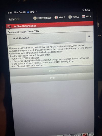

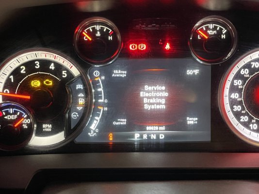

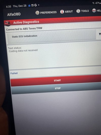

Ram brothers and sisters…I’m at a loss tonight. I finally got the Alfa OBD for my 2014 3500. I did the usual, watched a YouTube video, and successfully programmed a new key fob and I was ecstatic. Figured I’d go ahead and adjust my tire size (37’s) so I’d actually know my speed. I must’ve been the sucker that watched the wrong video or read the wrong thread but I got all sorts of issues. I programmed my tire size and thought that was it. A little later I got in the truck to drive the trash can to the end of our lane and holy $hit were the dash Christmas lights aglow! I have traction control, ABS, 4WD, trailer brake warning lights, reverse park sense won’t turn on, my digital speedometer is just “- - -“ and the analog speedometer doesn’t even move.
With a little reading I saw that I had to do an ABS initialization, but when I select that it’s grayed out. The instructions for ABS initialization state to first perform a static ECU initialization. HERE’s where my problem begins. The static ECU initialization keeps failing stating “coding data not received”. I am completely stumped and don’t dare to drive my truck anywhere. Can someone help a brother out?!

Change it back? Disconnect your batteries and hook the two cables together to drain the electronics of all power. Either the shtf of youre having a little glitch. Battery is the easiest place to start.

I changed it back, well should say I decided to just select the 35’s from the drop down rather than enter my own value. Ran the static ECU initialization and it passed right away! Everything is working as advertised now. Haven’t been able to verify accuracy but I’m relieved to say the least.

Honestly and not knocking aleksy in any way (alfaobd creator). But sometimes there's a glitch on either our end or His. Always revert back of there is an issue and never change too much at once or you won't know what caused the issue. I had a problem with my Alfa a couple years ago and he had it fixed so fast, with support like his I don't mind dropping money on an app. Especially with the power this thing has. You can change EVERYTHING! As posted above too there are alot of great knowledgeable people on here, not trolls like most the Facebook groups... Unless you ask something realllll stupid, then I'll jump on it lol.
