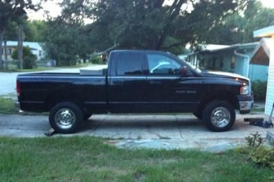

im looking for economical* 33's i could of gotten the 37's for right under $500, hoping to find some 33's for less than that and maybe even get some rims then. but this is my truck, did all the lifts with me and a buddy. this is without the 3" body lift havent had time to put that on yet. anyone knows a good place let me know thanks!

Your truck could use some rims. Buy mine.
