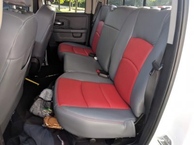

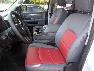

Definitely a time consuming project however worth the effort.
Material Quality is oem if not better!. The covers are mostly Velcro and zippers but there are hog rings that need to be replaced to achieve a factory look.
Only regret is not choosing a designer 2 tone pattern with colored stitching plus the fact I did the job twice. Added heated pwr seat frames from a laramie 6mo later..

That's actually a very nice self-install. I've seen some pictures where the leather was really wrinkled in spots, but apparently you were able to work through that. :waytogo:

Yep it came out good! Mine came out similar....a few wrinkles but most of them have worked their way out over time (pics were 2 days after I installed the seats)
I am having a problem with the drivers front cover getting loose in the butt (huhuhuhuhuhuhuhuh), I think its because there is no hog rings connected in the back because the seat heat pad is in the way. I might add some hog rings under the seat frame where the cushion cover wraps under.

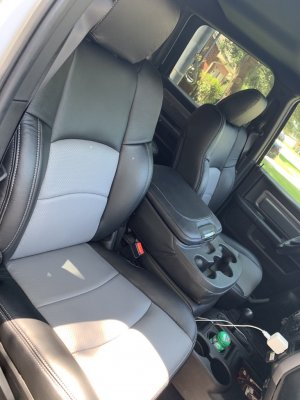

I upgraded my 2017 Power Wagon from vinyl to katzkin 100% leather (no vinyl anywhere) two tone w/contrast stitching, preforated inserts and degreez heating / cooling over the summer and I am very happy with the end result. I do still have a bit of a wrinkle on my center console that i'll probably get addressed at some point in the future but besides that everything else smoothed out quite nice.

First Ive heard of someone with the Degreez stuff, how do you like it?
When I went with my Katzkin I got a set of cloth heated front seats from a '15 Big Horn. No ventilation but Im ok with that.
For the rears I added a set of RoadWire seat heaters, wired to the battery for power and a dual output relay under the front seat (one output for each side of the rear seat)

Wow, that looks great. I didn't realize it, but it looks like the seats in your Power Wagon are slightly different than your typical Bighorn-type seats. They're almost shaped like Laramie seats or something. Anyway, they look excellent.

I love the degreez. I live in Texas and had it installed this summer so I haven't used the heat yet but the cooling actually gets quite cool. I frequently turn it down after a bit from the top setting midway through my commute. It isn't like some OEM seats that are only ventilated, these use the peltier effect to actually lower the temp of the air before it's blown through the holes in the seats.
