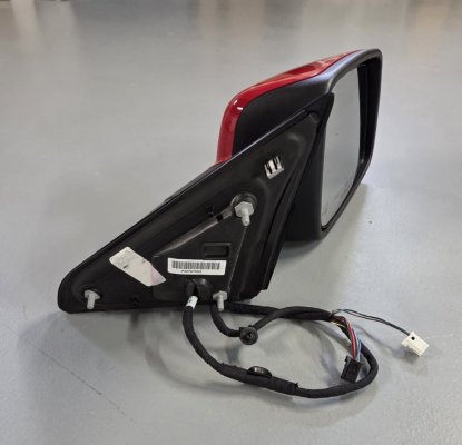

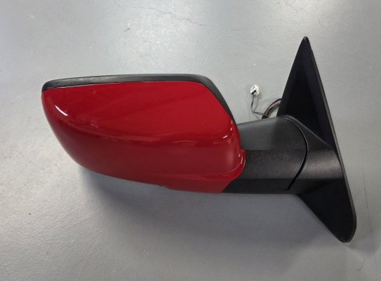

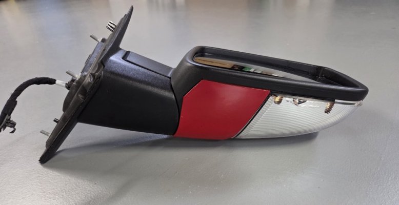

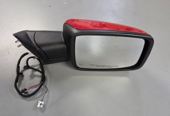

If you are still looking for a good used mirror assembly that is powered and heated. I have a good red one from my 2017 ram Sport. The only thing wrong is the glass had a few scratches on it. But it is very easily replaced. Asing 150.00 plus shipping.
