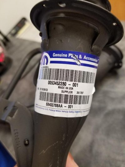

I don't know if the newer Rams are much different from the 2013 - 2017
In those years there was an issue with the fuel nozzle shutting off.
The issue was that the air pressure would shut off the valve.
Ram was replacing the whole tank, when the issue was the fuel neck & or the curvature of the fuel nozzle.

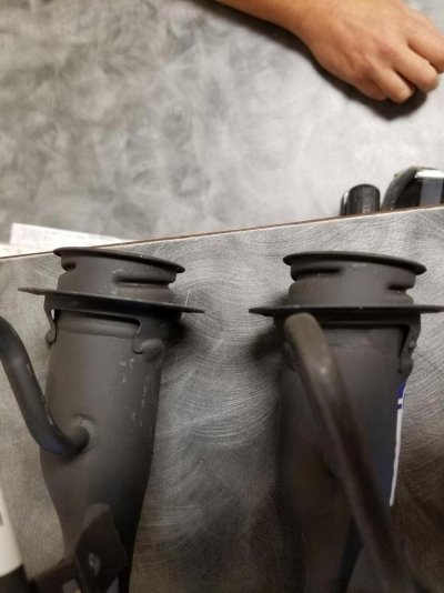

The Costco nozzles all where switched to a design that had too much of a curvature, this lined up the Rams vent tube hole with the fuel nozzles venting port, ( thats the little hole a the end of the nozzle ). This design kept shutting off the nozzle.
Ram experimented with the Vent tube entry port, this is what they came up with.
You may be able to see the difference between the old style & the replacement
You should be able to look underneath & see if you have a kinked hose, but you can't see a thing above the fuel tank
