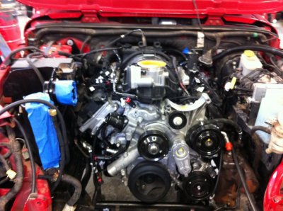

Hey folks.
Here is what I have.
2007 Jeep Wrangler Unlimited with a 2010 Ram 1500 5.7 VVT Hemi motor conversion and a Getrag 238 6 spd transmission. It uses a 2010 PCM with a special programming to work with the Wrangler instruments.
This conversion was done professionally about 30k miles ago and has been essentially flawless since then.
Recently once the motor is warmed up and it drops to low idle (it’s a 6 speed so clutch in foot off gas), it predictably will drop suddenly to very low rpm and will often stall. This does not register any CEL or codes and it will start and drive fine afterward.
However in the past week it has gotten markedly worse. Now it will stall anytime the engine hits low idle, and if I “save” it from a stall with some throttle it will start stumbling and go into limp mode. No CEL and no stored codes. It will illuminate the Red “Throttle Control Warning Light” (the red lightning bolt light on the dash).
I’ve checked all the wiring I can get to and all the plugs (accelerator pedal plug and throttle body harness) and they seem solid. Air cleaner is clean, battery is charged, gas is fresh.
I haven’t had time to dig in, but plan to pull the throttle body and clean it if necessary. Other than that I guess I’ll replace parts until it’s fixed (pedal, throttle body, etc).
Any thoughts?
