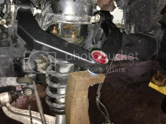

War Machine
Mar 10, 2013
225
109
6.7
Installed, took about 10 minutes per side
War Machine
Mar 10, 2013
225
109
6.7
It's still sitting on my hoist, just have to do the alignment on it
War Machine
Mar 10, 2013
225
109
6.7
The arms are about an inch longer than the stock ones and obviously greaseable ball joints

@war machine hey man sounds good. Is there anyway u get some pics with the wheels on and on the ground so we can see the uca's with weight on them. would much appreciate it.
