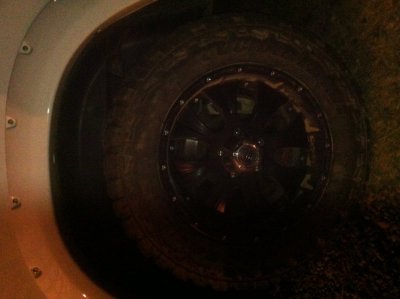

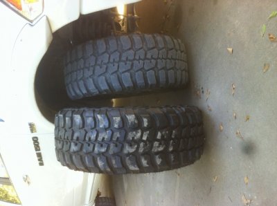

Tomorrow I'm getting my 35x12.5"x20 federal couragia mt's put on. I currently have the same tires but 33's. On my front suspension I have a 2.5" HBS Leveling kit and that's it. Idk what the offset or back spacing of my wheels are because they came with the truck. Questions are, will I rub the body of my truck, will 1/2" spacers hurt, and does anybody have pics of 35's on a 1.25" BL and leveling kit? Sorry for the questions but very excited lol

You should clear fine! Maybe trim the fender liners a tad, but that's it.

post a picture of your rims. maybe we can identify what they are and then we can research the offset/backspacing. Worst case, youll need 1/4" wheel spacers (which is no big deal)

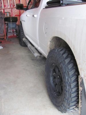

35x12.5 Toyo's on +20mm offset rims, I needed 1inch spacers to not rub the control arms, turning they work fine, only spot i have rub issues is the drivers side there is a little bump out in the inner plastic fender, so i used the heat gun and made it soft and pushed it back and now i dont rub at all.

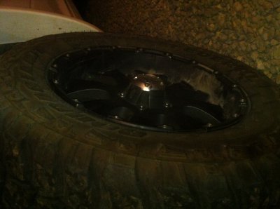

Well I got them on today and they rub at little right before full lock but I would still like to know what offset they are or something close to it.
