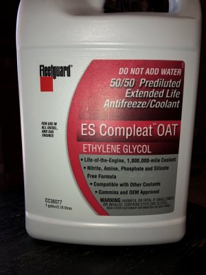

Around the 10K to 15k mile mark I will be attempting to switch over to this coolant.
It has been specially formulated and designed for heavy duty diesel engines not like the purple OEM universal coolant that comes in our trucks from the factory.
