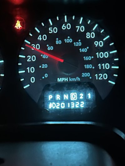

So I tore apart my dash the other day to try to replace one of the lights on my gauges. I unplugged the cluster and it all goes limp of course. I plug it back in and the speedometer pointed directly down and the fuel gauge went past E in the wrong direction. They both still work but obviously not showing correct. How do I fix this?

Nope to both inquiries above… didn’t think anything of it honestly. I just figured the speed sensors would reset it

If I remember correctly, you can try to do a reset on the cluster. Press and hold the odometer reset button and turn the key on, in a few seconds it will start to go thru a self-test. Release the button and let it do its thing.

So I tried the reset. It did the whole scan thing and thought it almost worked but sadly fuel gave and speedometer is off just the same

If it is not the connector seated correctly, a bent connector pin or two, or off by a pin, if that is even possible, then somehow the DIC was damaged.
