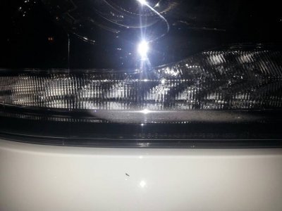

I have a 2014 sport and the headlight housings look like they have moisture in the bottom part of both lights. Has anyone else had this issue? Heres some pics below.

whats weird is its been like this since the day I bought it at the dealer. I noticed it on the drive home from atlanta (1000 mile drive) about 50 miles into the trip.
It goes away. It doesnt happen when its raining. Only when its cold or at night. Once the lights are turned on it goes away after a little while.
I'll check the back of the housing. But it only fogs up on the bottom of the housing where the turn signal and running lights are. If it was just one I would understand maybe its a defect. But both at the same time/brand new off the lot/same spot on both lights?

Mine do the same thing, but I've only noticed it after I wash the truck and it's cold out.

From the service manual:
ServiceManual said:
STANDARD PROCEDURE - FRONT LAMP UNIT MOISTURE CLEARING
Some customers may report that on occasion, vehicle exterior lamp assemblies are fogged with a light layer of condensation on the inside of the lenses. This may be reported after the lamps have been turned on and brought up to operating temperature, turned off, and then rapidly cooled by cold water (such as rain, or the water from a car wash). Lens fogging can also occur under certain atmospheric conditions after a vehicle has been parked outside overnight (i.e., a warm humid day followed by clear cool night). This will usually clear as atmospheric conditions change to allow the condensation to change back into a vapor. Turning the lamps on will usually accelerate this process.
A lamp that exhibits condensation/fogging should be evaluated in a service bay environment by first drying all water from the outside surface of the lens and operating the lamp for 20 minutes. If the condensation/fogging has begun to clear from the lamp lens after 20 minutes with the lamps operating, this indicates the lamp sealing has not been breached, and the lamp does not need to be replaced.
If the condensation/fogging has not begun to clear after 20 minutes with the lamps operating, or the lamp has large amounts of water droplets visible on most internal surfaces, this indicates a problem with the lamp sealing that has allowed water to enter the lamp. In this instance, the customer is also likely to report that moisture in the lamp is always present and never disappears. A lamp that exhibits internal moisture permanently should be replaced.

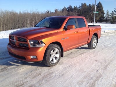

I have the same problem on my Customs. The funny part....... It's just over the Led switchbacks. There's not enough heat generated by them to burn it off right now.
Looks exactly like the same problem your having over the Led signals on your factory projectors.
I had just washed it the day before. My truck stays outside. If you can zoom in.... you can see that it's mostly over the signal. Just a tad on the high beam.
So, your not alone. It's pretty much exactly the scenario as what Jeepguy_1980 posted on the TSB.
JJ built them.... so you know there's not going to be any leaks.
I might try a hairdryer on the outside to see if that helps. I have a heat gun.... but i think it may get too hot.

Mines not leaking. I doubt the others picture are either. Temp differential, condensation, and humidity. Lack of heat from the Led's to produce enough heat to burn it off.
The signal light portion is sealed apart from the hi/lo-beam section my the Lexan cover. In my case, that's what it is.

Sucks, but the heat gun did work on getting rid of the fog.
