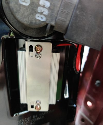

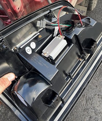

2) And I should have taken a picture but mine do NOT look like the advertised ones on the website where it has two resistor boxes in black (see below), mine is one resistor box in naked metal:

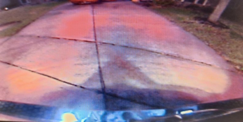

So I got these in with the diffuser that are also not so tall, but alas the reverse pattern on my backup camera looks the same. The bulbs themselves look MUCH better now as instead of black and sticking up tall behind a clear piece of plastic, these are silver and small and so you don't really even see them which is nice when they aren't on. They are plenty bright, its just the pattern of the reflector itself has banding and gaps in coverage which I didn't have with the stock diffused ones. This is a picture of the reverse camera to illustrate what I'm talking about:

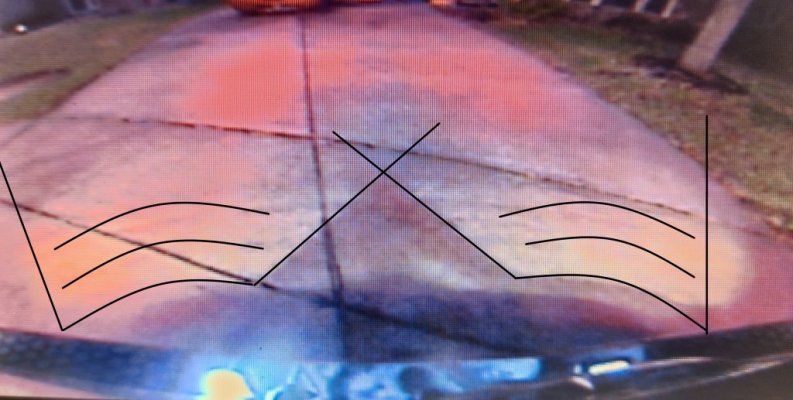

It doesn't show up as well on camera, but I highlighted what I notice in person more:
Its still perfectly functional and you won't run into anything, but its a downgrade from stock in that respect which produced a much more evenly distributed light without banding IMO.
Also, just an FYI I don't know if they updated the model but this is what I was talking about where instead of two black boxes on the inside for the resistors, it has only one silver box (perfectly functional, no errors, just odd that its different):
Its been a while since I installed mine but I don't remember it looking like that inside either.

So I was just reading more Amazon reviews, and this guy's look just like mine, so they must have updated the product. Again, it works perfect, so no complaints if they updated it.
^from another customer

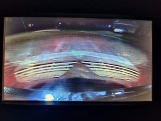

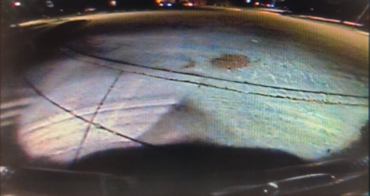

LOL, total fail. So we tried some 4000 lumen crazy bright Auxito 912s that rival headlights, and sadly while they DO look really cool in the housing because they are almost invisible and their black base is more attractive than the factory weird discolored connector, the distracting lines they make on the ground are horrific and worse they make the reverse camera intermittently go crazy like in the horror movies with weird flickering and fuzz from some kind of electrical interference. So these can be ruled out!
Very uneven light as you can see in either orientation.
Clocked parallel:
Clocked perpendicular:
The only thing we haven't tried that we'll try tonight are incandescent bulbs, might just have to go with those for the reverse. Real shame, wish they had just made it flat frosted or textured glass to easily perfectly diffuse the light, that would have solved everything.
If anyone finds bulbs that work without weird lines showing up with these taillights, please let me know and post a pic of your reverse cam if you can as I'm going to be stretching the limits of how much I can return to Amazon before they blacklist us, lol! :p

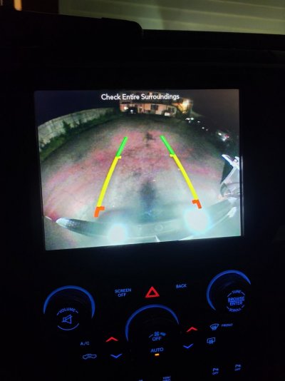

I have the auxito brand 921s for the reverse and I'm honestly impressed with them. This is the view from my camera. I can turn the bulb multiple directions to get the best pattern out of them. Yes, they're more expensive, but they're a higher wattage. 20220508_222440.jpg
