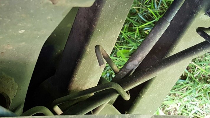

I just found a squeak last week. Ended up being where the emergency brake cables run through a metal bracket by left rear wheel.

What exactly would I be looking for to see if that is the problem or not?

I just had my son bounce on back bumper while I laid under truck.
