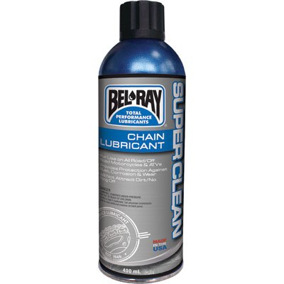

I have the same sqwaunk and I keep a can of aerosol grease in the door for safety chain quick links and the likes and I try to hide down the spring, the roller and the door stop link ... to no avail. Just a horrible noise. Drives me [emoji529]
