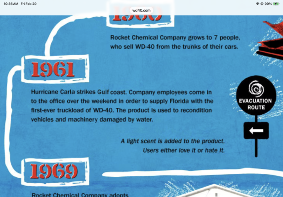

There’s always been a degree of B.S. associated with WD40. Even the company’s own advertising has errors. (see the attached….where Hurricane Carla is said to have hit Florida…when in fact…it hit Texas. Hell, I was There!” As a young Boy Scout we finished Hiking merit badge with a 50 mile hike from Houston to Galveston and witnessed grass hanging on the top strand of barbed wire fences from flooding 30 miles from the coast!)
