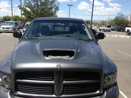

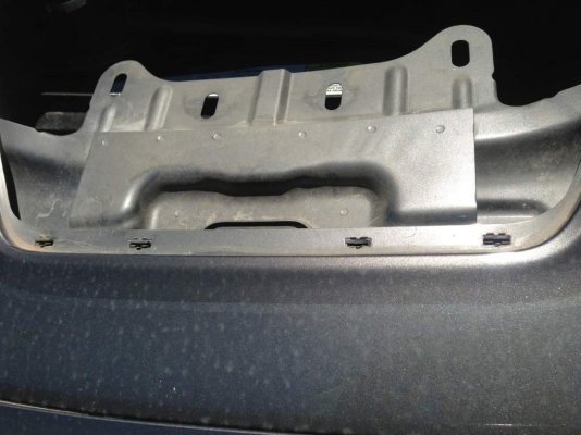

Well today I was racing my friend for a short 25 roll. I don't think we even got to 50 then I saw something fly off from the front of my truck. So I pull over and sure enough it was the insert in my SRT-10 hood. Luckily it flew off and landed in a grassy median, paint up. No scratches or anything! So now I'm stuck with a huge hole in my hood until I figure out how to re attach this. What happened is that the clips that hold it into the hood at the front, sheared off the insert. So has anybody dealt with this before? And how did you fix it?

Unfortunately it is a **** poor design for attaching it. Two of mine broke, but I was able to use screws up from underneath to hold it in place. Maybe epoxy something to act like a screw? I wouldn't trust it, I would start looking for a replacement. Sucks because new ones are like $240 last time I looked.

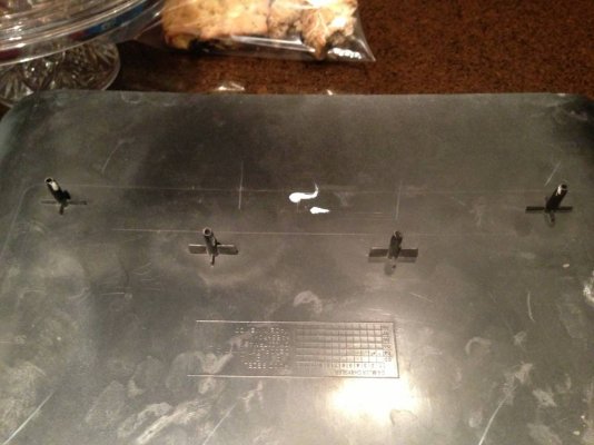

Crap, that's what I was dreading. So could I get those pins that sheared off, plastic weld them back on, then use a bit of threaded rod in the four locating pins, and use that to bolt it on? I really don't feel like getting a new one, then having it painted and all.

Yeah. That's what I'm picking up tonight. And some threaded rod. I'll show you guys what I'm thinking of doing in a bit.

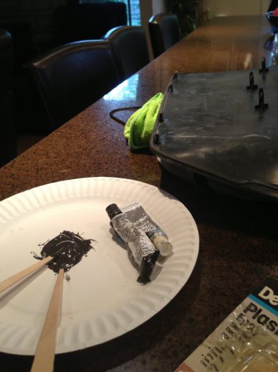

Alright epoxy is setting. Me and my dad decided to run a bead of silicon sealant around the perimeter of the insert. He has some pretty serious stuff that holds our aluminum sink in place, so I'll do that too.

The insert says ABS+PC on it in the middle. The stuff I'm using is a plastic epoxy. I sanded down both mating surfaces to ensure it got good grip.
I have uses that type of stuff before on models. Also I used a similar chemical to weld plexiglass together. It works good. But I wouldn't trust it to the insert. When I used it on models, most time I could easily pry it apart with little effort.

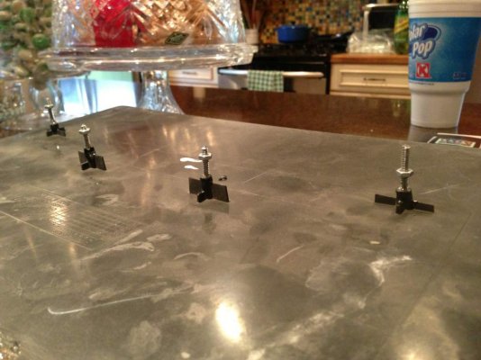

I'm also going to be trimming these down and epoxying in some threaded rod so that it can bolt it down to the hood. Needless to say, when I'm done with it, this ***** ain't coming off! Haha

Epoxy is setting on the threaded rod. So I'll be bolting it down, and putting silicon around the edges.
