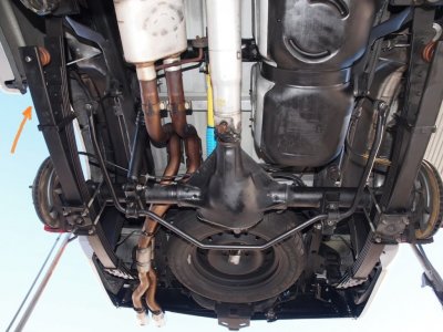

Can you post a pic? If you're referring to what I think you are, it isn't a helper spring, that's a snubber for traction. See the arrow, that what you're talking about?

That’s them exactly! Thanks, they are original, I’ll leave them on as I do not tow.

They're sorta like factory installed traction bars, though you'd get a helluva lot better performance with a set of Cal-Tracs.
