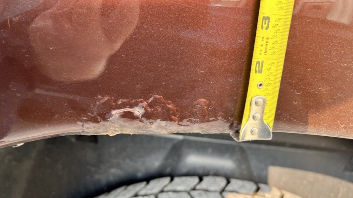

measure the distance of the rust and see if the flair would be wide enough to cover. I had to go with a set of bush Wacker flairs to get enough depth to cover.. I still have to pull them back off to fix the rust.. Im just going to treat the rust and por 15 the spots and leave the flairs on. For me it would have been cheaper to have a shop do the color match.. White color match did not cover worth a crap and took way more than it should and had to do clear after just to get it to shine

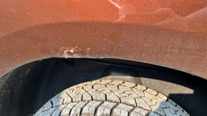

Here are some photos of the rust...
Warning! The following images may be disturbing: Viewer discretion is advised.​
Sorry for the dirt...it's been raining all week, she needs a bath!

I'd opt for either factory or Bushwacker color-matched flares.
I think stainless would look like two frowns on the side of the truck.

I'd spray some fluid film on the rusted areas a few times a year otherwise it won't matter what fender flairs you put on it in a few years once the rust gets bigger.

I'm going to try some rust converter on the visible rust and definitely some fluid film for up in the back side of the fenders!
