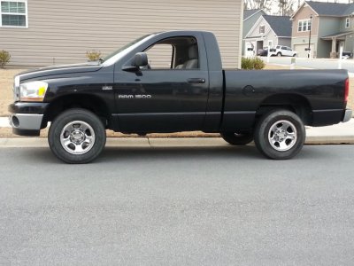

My 06 rcsb is about 1" up in the front due to new strut assemblies. I'll post a pic in a bit.

Hey sorry its late, lost the thread for a while, and got busy with the beautiful weather. All I did was replace my strut assemblies. New springs and all.
