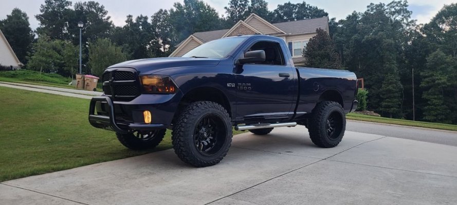

MCas86
Feb 11, 2021
46
44
Georgia
I did a 6in lift from RC on 37s and I haven't noticed any issues. Same as MPRBLUZ, just a stiffer ride.

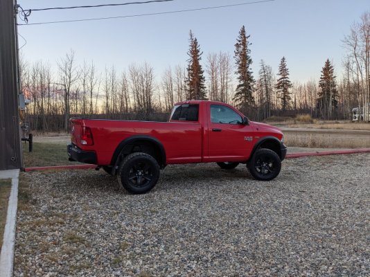

lokes_treachery
Nov 24, 2021
8
38
Canada
5.7 L HEMI
Hi,
I just got my '21 1500 Tradesman lifted 4" with the Mopar kit PN: P5156106. No issues to report; it's been about 8,500 km or 5,000 miles since installed. Apparently it's the same as the SuperLift kit but I'm not able to confirm this.
