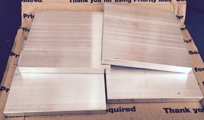

ok cool, my 1/2" thick 5"x5" aluminum metal pieces showed up today, going to try and see how my adapter idea works out sometime this week(fingers crossed) Need to sneak some time in the garage!

What kind of tool will you use to cut the aluminum?
Or are you taking it to a machine shop and having them cut it?
So I will be drilling/finishing these in my garage with regular tools......I won't even be using a drill press......just a regular corded drill and a careful hand.......should be good enough to prove the concept.:favorites13:

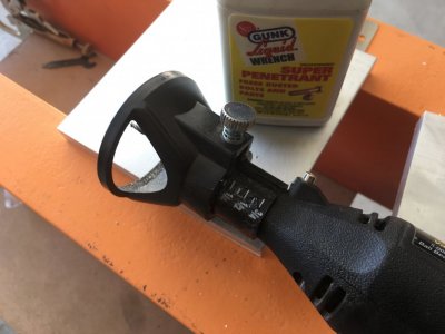

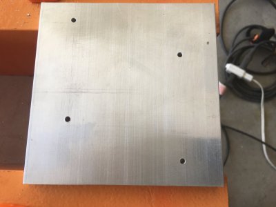

ok so I cheated a little, I did not drill 100% free hand pilot holes after all, in fact, I didn't even use the drill motor I intended to use..............instead, I ended up using my dremel with 1/8" drill bit and the slide portion of the router head left loose so I could use it as a short travel plunge.......I coated the outside with urethane grease so it moved a little smoother...........I'll be damned if these holes aren't better than 1/64" accuracy both sides! :33::33:
Now "I will" use the drill motor with a step bit and finish the holes........................

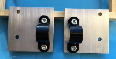

these are done for now, test fit on the adapters is good, need to clean up a bit and see if I can mount this beast of a rear swaybar! :893karatesmiley-thu:893karatesmiley-thu

So I'm guessing those plates will bolt on to the stock location?

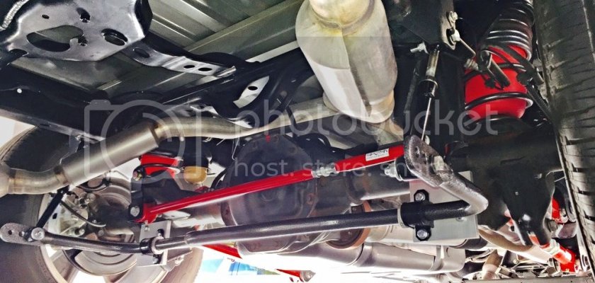

mock up:

Well I'm happy with how it all went together, no apparent binding or clearance issues........ please excuse the grade 5 hardware for now as that's all I had on hand in all the different sizes to make the magic happen :grd:
The Hellwig adjustable rear end links supplied with the bar worked perfectly; so no need to buy different hardware there.

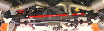

just got back from a test drive, very happy with the performance here. I'll update the thread with my driving impressions/details in a bit. Going back out for some more fun!
For those interested in the bar I used, see below:
