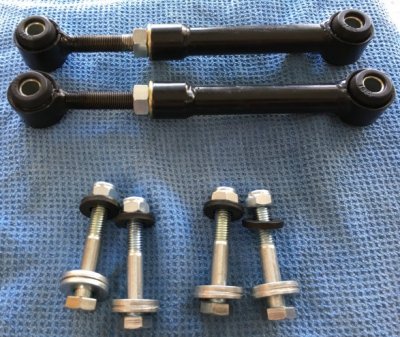

visually and aesthetically speaking the 5" x 5", 1/2" thick aluminum adapter plates aren't the best looking things in the world, and I'd really like to take away some material and add a design element into the mix............unfortunately, my tool selection isn't what it used to be so it may be a bit before that happens........it's on the list!

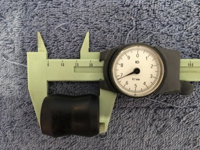

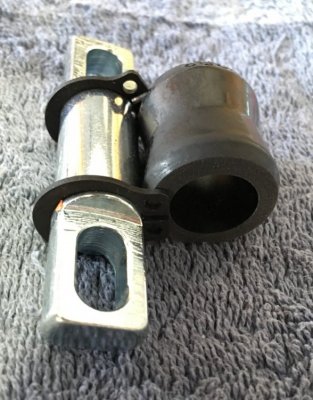

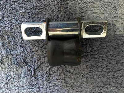

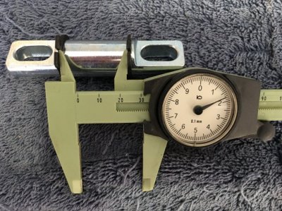

So the bushing doesnt squish enough to put the c clips on the tbar? What if u used a press to squish it enough?
Sent from my SM-G900P using Tapatalk
Seems like you might want some preload in there
