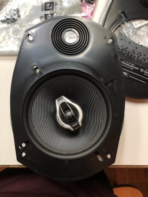

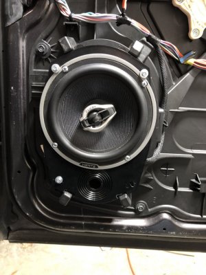

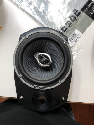

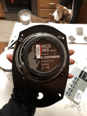

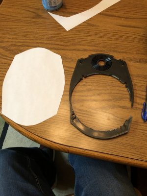

I found a good deal on a dm-810 that i was thinking about but i failed on step one already... smh these 6x9 to 6.5 adapters suck.. i broke one trying to cut out the whole large enough and on top of that i had to notch it for it to sit flat. Now that it does bolt up.. I dont know where the speaker screws are supposed to have any meat to go into.. they include little wingnut type plates but that seems rattle prone.. I’m not happy with these adapters and not sure there’s any good options
IxsharpxI
IxsharpxI
Dec 15, 2019
46
6
Missouri
Pretty frusturated at first and ended up getting the first speaker in (ugly but in) but the second speaker went a little better. Used a drum head on a dremel this time instead of a wheel. They might work out but not the best solution still. My Chevy speaker adapters were so Nice

Got all the speakers in and it made a significant difference in sound. Now im getting ready to order my power wire. Im debating between 4 or 0 gauge. In my last truck i ran nearly the same system (xd400/4 and hd750/1 or TE1501D on 4ohm) on 4 gauge and 100 amp fuse. On this one i know im borderline specially with adding another 2 channel. i know im right around the 100-125 amp range unless i use my TE1501D, which is the top for 4 gauge. I dont wanna spend the extra $100 for 0 gauge though I think if i just fuse it carefully and keep an eye on it i will be fine. Not like my amps will be turned up to 100 all the time.

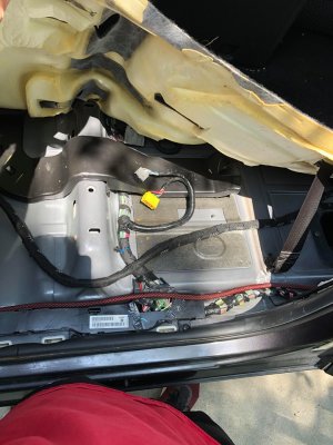

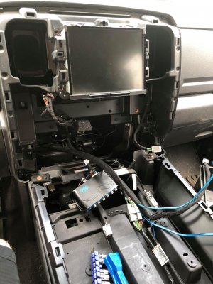

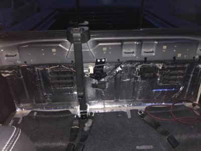

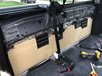

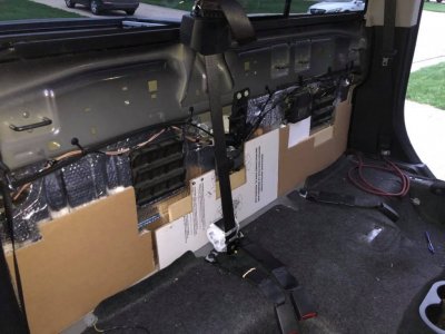

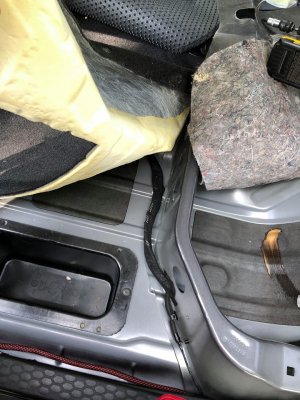

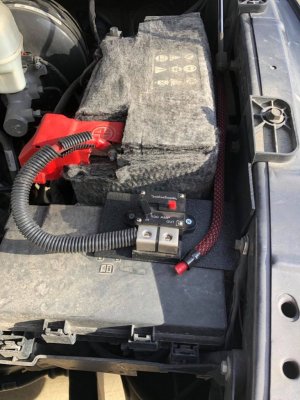

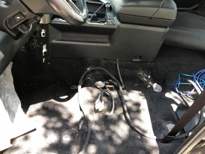

Had some time today during quarantine to get some work done. So far i made a fuse holder from 1/8" ABS that came out good. It was my first time using this technique. I found a fender bolt and mounted it there out of the way. Next I ran the 4ga wrapped in that awesome braided sleeving, i still need to shrink wrap and finish the ends. Then today i got around to getting the back seat taken out and about 80% of the sound deadener on the back wall. Didn't look like a ton of room behind the seat if the carpet is still in there. I don't think i will keep it and just use 1/2" mdf or abs plastic for a amp rack.. any input on this would be great as well. I saw a great picture floating around this site that im going to try to mimic
also i picked up a helix dsp pro mk2, and director for this build
Thanks in advance

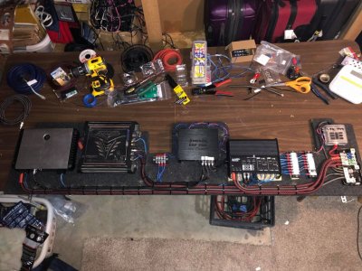

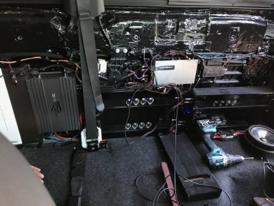

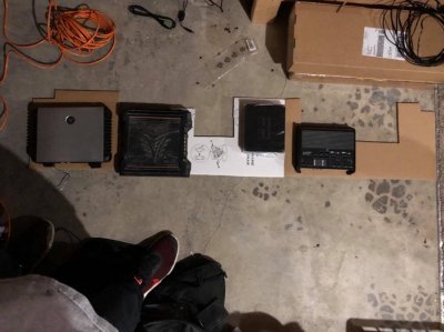

Did some more work tonight making a template for an amp rack out of some simple cardboard. Getting the main shape right and will add a couple inches on the bottom. Then i started laying out my equipment on my amp rack and found a decent layout. Im also wanting to plan for a possible mtx te1501d which is a bit longer. We will get it made out of wood and see what happens. the kicker at this point would have to be lifted to clear the vent. I would rather just replace it with a smaller 2 channel or replace the 2 and 4 channel with a six, but the general amp rack shape will stay the same. I think its as good as it can get to use all of the space. Power distribution is planned for the far right.
92458157_2575467969342112_3558602171077361664_n.jpg 92198952_221328892314624_5534397142824648704_n.jpg
TomT
Jul 1, 2015
1,281
565
SoCal/OC

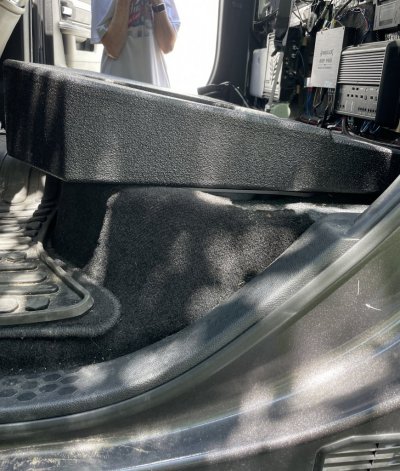

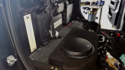

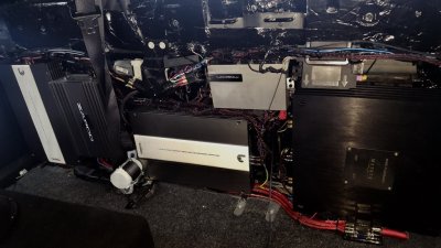

Here’s my back wall which is about as full as it can get. Maybe it will help with layout ideas.1BEE2906-5640-40DA-87E4-7C58AA9ADA0E.jpegB6E2DA7C-B695-46A7-A571-312271F9CFA2.jpeg3A6C7E92-CE73-4044-9988-93E3F14C8754.jpeg95222B29-9933-450B-BF34-35AC5426AFD6.jpeg

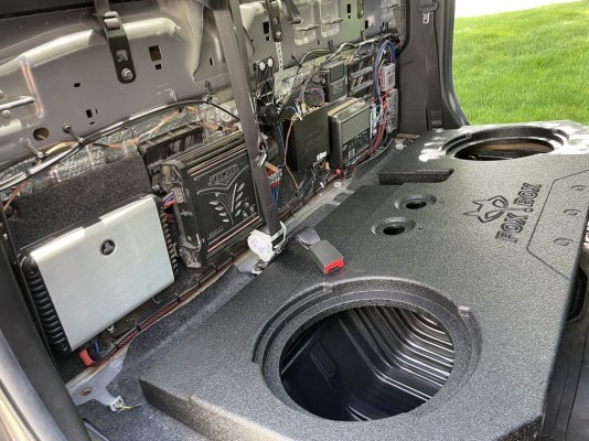

Got my amp rack cut out and test mounted. Im really happy with the fit and sure, i wish i would have cut a little less in a few places but its a great first shape. The 3 mounts hold it really solid although I think i need to do something to keep to top corners from vibrating against the wall. They flop around a bit. I've thought about trying to find some 1/2 abs instead just cause its already black and i dont have to wrap it. Plus im thinking about cutting out 1/2" blocks to raise the kicker amp(for the vent and to run some 4 ga under it). I layed it out to start getting and idea of the wiring situation. Made me really think again about looking for a six channel. Lots of wires and not a lot of space..except all that blank space on the right. Might move the dsp over there to try to seperate the signal from some power. What do you guys think??
