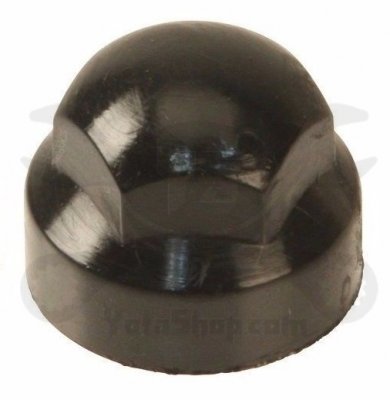

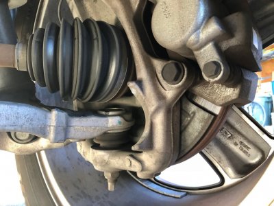

THAT specific clunk is usually the stopper crescent on the back of the spindles beating/grinding on the stop pegs. See the image where the shiny parts are and how the stoppers are all ground up. It's designed to prevent too much deflection on the front end. You'd be surprised at how many trucks have this issue. Toyota even made a TSB out of it and they put plastic caps on top of the stopper pegs so those grind differently than the metal to metal. When someone complains and they have a ton of miles and the campaign fix was done you charge $10 + install the replacement parts since it's out of warranty by then. They're called "Knuckle Stoppers".
