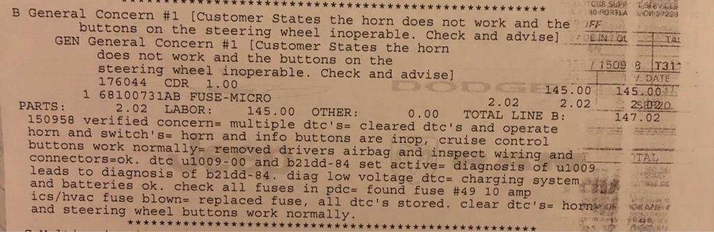

Here is a pic of the invoice. Not sure what a clock spring is.

I had the same problem.
No horn, radio buttons, or evic buttons working. I replaced the wiring harness in the steering wheel and clock spring.
Fuse Number 49!
I swear I checked them all with a test light.
If anyone needs to buy a new clockspring or steering wheel wiring harness let me know4ed5aaa5dfd661e7b9cb8540f3d47301.jpg
