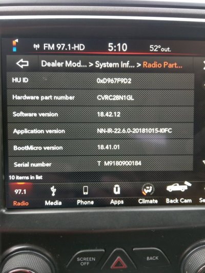

Hold temperature up, temperature down, and defrost to enter into dealership mode. You are looking for this screen (post a picture of it or conversely, write out what it says you have for "Application Version")...

Thanks. Will try to get that version number tomorrow

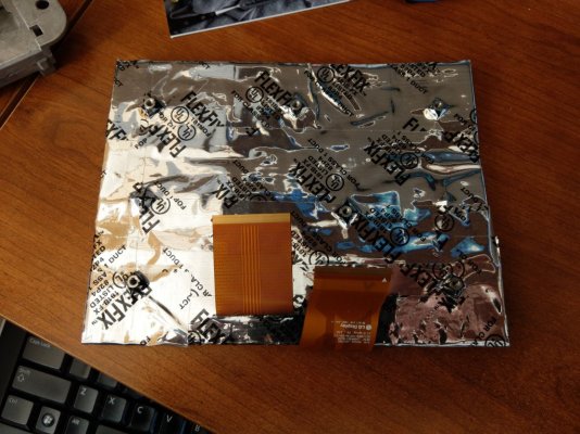

I actually sold that radio for cheap to a member letting them know what I "would have done" but with my UAQ I did exactly that. I added two fans, a fiberglass heat shield between the screen and radio, and replaced the OEM thermal pads inside...with these additions I honestly feel like the radio is consistently snappy in it's response and it prevents "ghost touching" and further delamination on this screen (which I got from another member who was getting ready to throw it in the trash).
