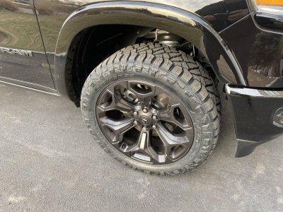

I would not venture too far off road with the stock rubber on the 22’s. They are basically street tires.
These would be much more fitting...
