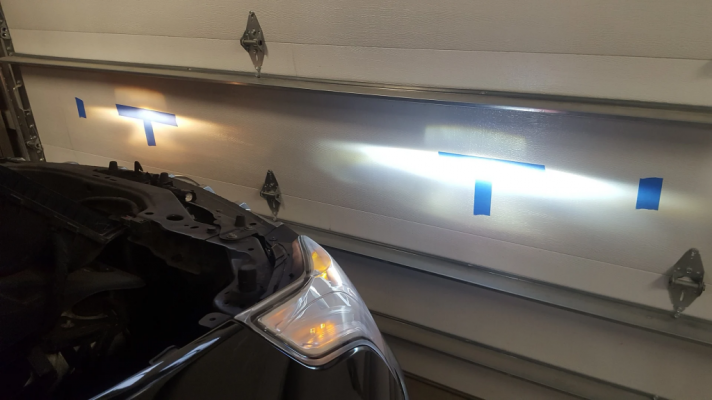

I have the 17 as well and yes, the low beams sucked. Tried the Silverstar Ultra and that made zero difference. I still have the pair if you want them...free.
Some will say you have to spend $150 to get good led lights. It's your money so feel free to do so but there's really no need. Do some research and you'll find a handful of reasonably priced, quality options. Here's one.
I can't find pics from the Ram swap but did the same upgrade on my wife's car with the same results.

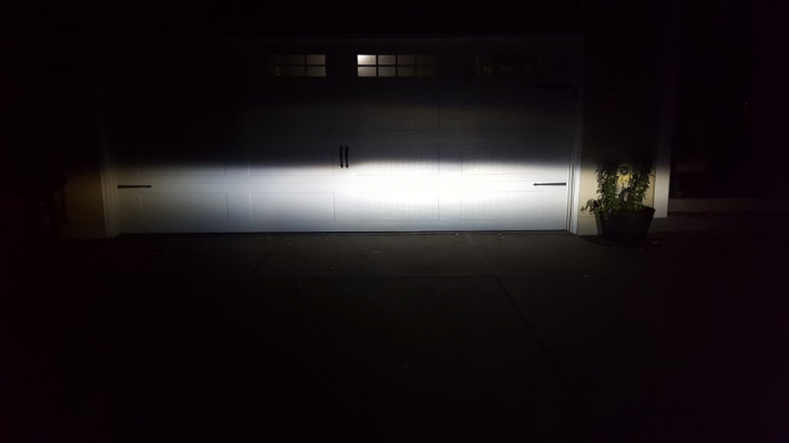

This is the light pattern at 20'.
These $30 leds made a big difference in both our vehicles. Fully plug and play. No errors. No reprogramming. Running 3 or 4 years now without issue.
Are there better lights out there? Sure, I don't doubt that. Your choice but this is apples to apples. 2017 Bighorn with quad halogens. I put them in my fogs as well.

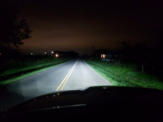

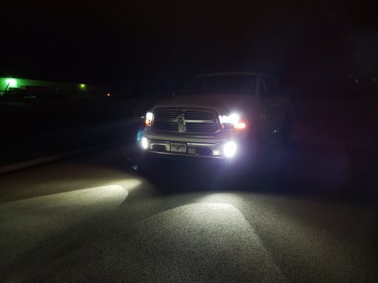

small
Heise LEDs with anti- flicker module, plug and play, worked perfect

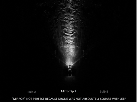

Same camera, set to manual mode so no change to shutter speed, same vehicle, same altitude (I changed the bulbs while the drone was hovering in one spot) .
Mirror image (so you're looking at the driver side only, to eliminate bias in the terrain) . Cut to black and white to eliminate human bias about the color temperature. Both bulbs swapped at the same time between photos. This is in a 2015 Jeep Patriot, no way to swap that fast in a Ram
LEDs are Hikari 2020 Megatron (not cheapies) .
Which one's the Hikari 2020 LED and which one's the $23 halogen?
