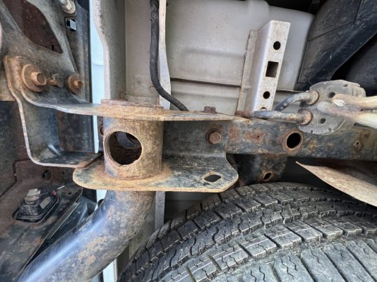

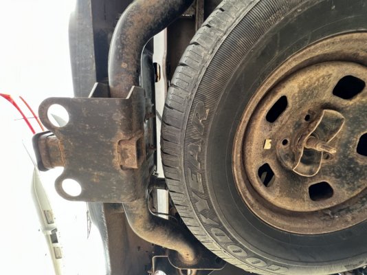

That’s what it looks like when I look under the truck, but because I live in Canada there is quite a bit of scaly rust underneath… I’ll go out and post pictures from the underside.

leafsby2
Apr 9, 2022
21
14
Canada
Sorry for the crappy pics but it’s all I could do from underneath

crash68
ACME product engineer
Mar 20, 2016
12,333
21,423
3.0 EcoDiesel
That's the Class IV hitch, with the Class III the 2" receiver tube is bolted on to the cross bar.

leafsby2
Apr 9, 2022
21
14
Canada
Thanks for your guys’ help. Question has been resolved.

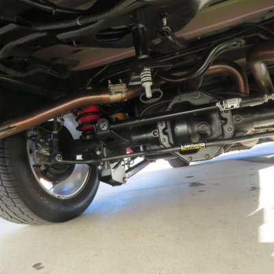

As Crash said above you have the class 4 hitch. Some time spent with a wire brush and POR15 will make your under carriage look better.I'm in Alberta and the bottom side of my 14 looks like this,but i am **** about keeping things clean and painted,lol

Atcer2018
Aug 10, 2019
1,488
2,506
Virginia
3.6
Holy cow that’s clean! Kudos to you.
turkeybird56
Aug 2, 2018
25,566
56,162
Central Texas
I am in TX and the bottom side of my truck does not EVEN look that clean, nice...
