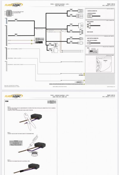

For the 2018-2019 rams, there is a security gateway that needs to be bypassed. This is the reason the flashlogic kit has you cut two wires and tie them into the trailer brake controller CAN bus wires. You can order the connector and terminals to crimp onto the ends of the two cut wires for the flashlogic kit for a few dollars from digikey, and plug it directly into the truck’s CAN block. That way you don’t have to slice any truck wiring. Looking at 12v website, they don’t offer a kit for 2018-2019 rams. This is probably because they haven’t figured out how to bypass that gateway module without splicing wires just like the flashlogic kit.

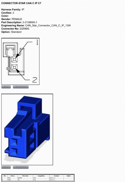

Here’s the connector your looking to buy for the CAN H and CAN L- z3akoDs.jpg
You can buy the connector here- https://www.onlinecomponents.com/te-connectivity-amp-brand/221386501-45132283.html
Terminals for that connector- https://www.onlinecomponents.com/te-connectivity-amp-brand/59637151-44176850.html
The brown/red wire goes into pin one on that connector, and the brown/yellow wire goes into pin two.

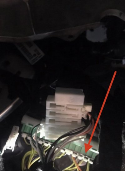

Then, that connector gets plugged into this green block under the steering wheel, any empty slot- Gx7BNCf.jpg
I don’t see the ignition wire you’re talking about, though, just the brown and purple wires that get tied together on the flashlogic harness itself.
You insert the circled wires into the new 2-way connector using two terminals I have linked above. Then you plug that new 2-way connector into that green can bus block I have pictured above. It’s under the dash by the steering column in the vicinity of the other connectors you plug into. So, you’ll ultimately have 4 plug n play connectors to plug in- OBD port, headlight switch, ignition switch, and green can bus block.

I wonder if they've changed the new harnesses, because they don't show combining the brown and purple wires any more, just connecting the brown/red and brown/yellow wires.
Or maybe the ebay ad is just showing the wrong set of instructions.
