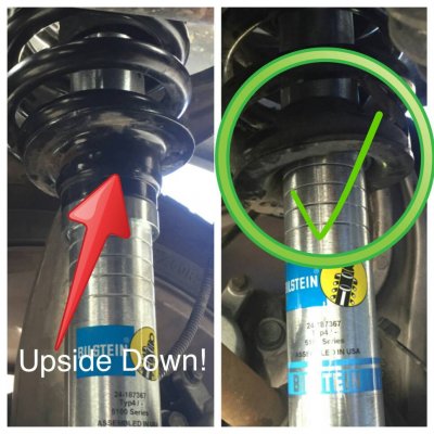

Well, I got the bilsteins in today. Can't wait to tear into this weekend. Only question is "do I attempt to use a spring compressors and do it myself, or take it apart and go to a shop to swap out the shocks?" What have most of y'all done, and how hard was it to compress the springs?
Do it yourself, very easy, just remember that top washer bikstein provides goes under the top spring cup and not under the nut
