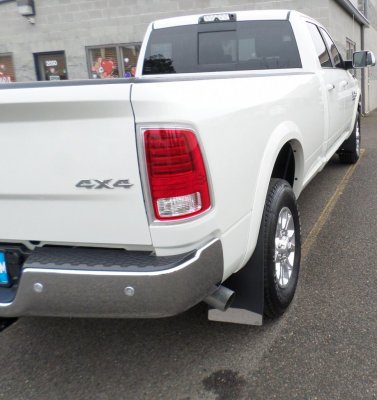

DuraFlap
Dec 3, 2016
39
17
6
My DuraFlap mud flaps keep all the rocks and mud off my truck and trailer.
