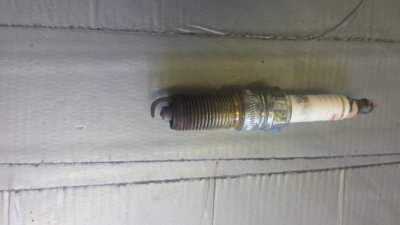

Hi guys ,been ghosting here for a while and learning about these HEMI's . Well I bought a 2004 1500 RAM with the 5.7. Long story short, I've had it for a bit over a month and in the process of changing all the fluids. I pulled a plug just to check and the electrode was worn down to the ceramic. A gap of .085 !! The ODB scanner was NOT throwing any codes. The engine just lacked power.
Well I changed them out with NGK 5306 and gapped then to .045 with dielectric grease and aluminum anit-seize. Well after that the mileage went form 15.5 to 12.4 MPG !!!!! I can just about watch the fuel gauge move. Do I need to remove battery cable and reset the ECU ??
