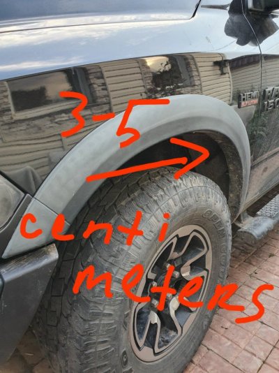

We measured the distance of the wheels with a tape measure, and it turned out that the left driver's wheel was in the wrong position. I will try to show in the photo that the wheel has moved 3-5 centimeters. What could it be? Examined the chassis and found no problems. The levers are intact, nothing is broken.

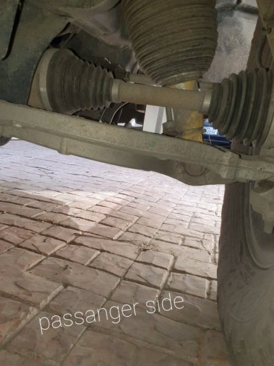

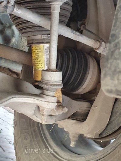

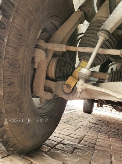

Can you take pictures of the alignment cams on the lower control arms? There are four total positions, one at the front of each lower control arm, one at the rear of each lower control arm.
I think that maybe your wheel alignment has been adjusted with an offset and that is making the reported steering angle (in the rack) different from the wheel rev count when you travel around corners.

Ok, sorry, I don't know much about the details, but it's good if I photographed correctly. Here I throw some photos.

And more... Hopefully right :oops:
