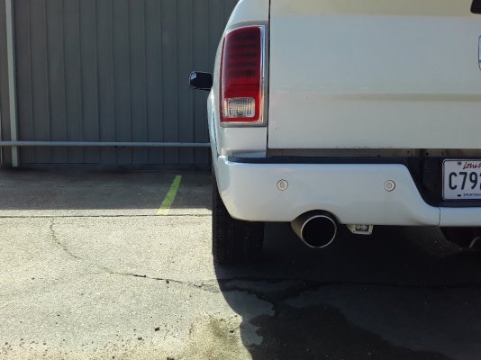

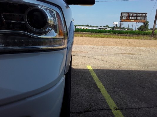

Sorry for the late reply. I just went and took some pictures. Mine are 22x10 with a +25 offset. I have about an inch, maybe less, before the tire is flush with the fender flare. Without the flares I think the tires would be flush with the body.
When the truck was on the lift the tires were much closer to the A-arm with the suspension drooped. Once the truck was back on the ground and the suspension leveled out, the tires were pushed away from the A-arms.
The front is stock height and the rear is lowered 2''. I would think if the front dropped more the A-arms would be even farther away from the tires.
