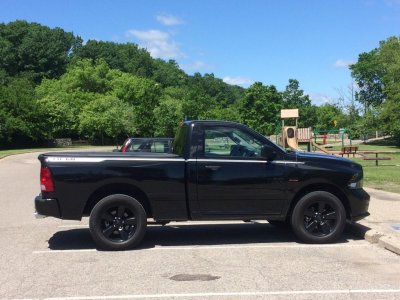

This is my 4x2 with a 5.7 that I want to lower.
Bell Tech has a nice looking package (964HKP) but it is $1,676 and the Michigan and Ohio shops I have spoke with say $1,200-$1,400 to install. I know I am getting a performance handlng kit not just lowering it but north of $3k is a lot of money. One shop I talked to said they had contacted Bell Tech and they said they have not sold any of these kits yet. So any advice on the best way to do a 2-4 drop without any loss in ride or handling? Also any suggestions for a install shop would be great, I will not be doing this myself.
Thanks!

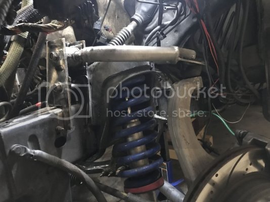

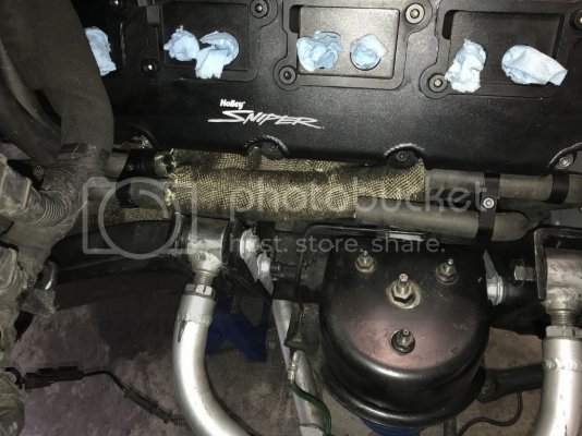

After running around with the 4.5/6.5 for the past few years and having a lot of angle on the front upper control arms I decided to do something about it. As I had the engine out for the swap, I decided to raise the upper control arm mounts.
I did have to notch the passenger-side mount to allow for clearance for the long tube headers. There's not much room between the primary tube and the upper mount but the header is wrapped so the heat shouldn't be an issue.
They turned out nice Kurtis.You are an artist with a grinder and flap wheel,the finish polish on them is outstanding,lol.
