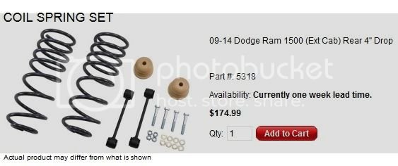

Just wondering how you guys feel about this. We all know the gf kit is pretty expensive for a cold spring lowering kit and it's a 2/3. Its been killing me to find a different option. So I called gf to see how much they would sell the front springs for since the back ones can be used from any other kit on the market. They told me 225 for front coil springs. So I'm going to buy the front springs and then buy the belltech 4in springs for the back that comes with the end links for $150. So that is 375 for a 2/4 without shocks. Not bad imo. Shocks are relatively cheap and you have the option to buy whatever shocks you want. $375 compared to $8xx is awsome.

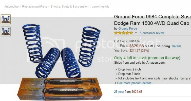

If $899 is the best price you found, you didn't look very hard.
The GF 9984 regularly goes on sale, with everything you need including shocks
on amazon.com for $499 Shipping included anywhere in continental U.S.
Just checked and it's currently on for $629
After you spend another $100-$150 on shocks
The difference is not $375 vs $900
its only $100... ($375+$150 vs $629)
and for those that bought the GF kit for $500 by shopping around
....you saved almost nothing :crazy:

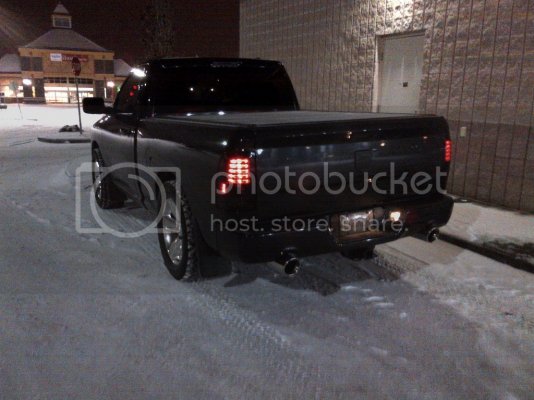

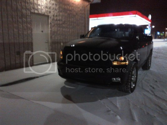

My 2/3 GF kit actually measured out at 2/4
...as you can see in the pics it sits dead level,
and I've had no issues with GF shocks after almost 5 years.
Also DIY installed (including strut tamer)
at my bro's bodyshop for nothing in about an hour and a half
