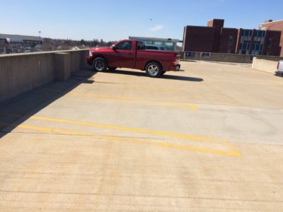

Etroze86
Nov 4, 2012
4,807
862
Grand Forks ND
OK guys finally got some pics of the drop done. I don't have starting measurements but I can say this. I love the tiny bit of rake I get from the 2/3 drop compared to just 2" in the rear. First pic is just 2" and second is the 2/3 drop.View attachment 46859
