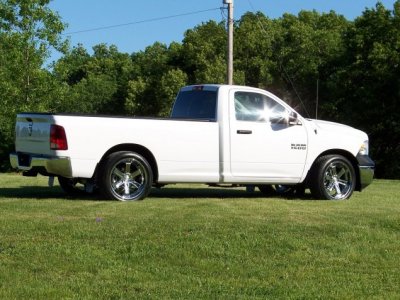

here are a couple more pics that were requested... I should have some better pics soon. It will be in a photo shoot very soon.

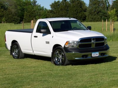

Here are a couple of pix of my 14', GF 2-3 drop with 22x9.5 and 285's... air lift 1000 bag kit in the rear with on-board compressor... I would like to go lower but I like the compromise of looking much lower than stock but still being able to use it like a truck......
