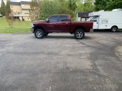

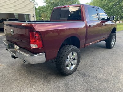

4EC2BB45-2A50-49F9-9DFD-738168C0D79B.jpeg E26720DB-216F-4F9A-A970-C1CE2727E985.jpeg 9577B59C-E952-4C53-92E8-F4C1F8F581BF.jpeg 9B9687DF-9609-4665-9136-DC2604BD8CF0.jpeg 17EC275F-95B2-4644-8C83-A1126D850D24.jpeg The goal was to get a little more of the rake out of the trucks stance. I’ve had a 6” lift with the Bils at .7” forever now and decided to put the Bils up higher and it turned out great.
Next step is to actually get the wheels tucked in a little more. Right now it’s got spacers on the wheels (used to have flares). My goal is to get a set of wheels that have the tires just barely sticking out further than the fenders w/o flares.
but getting the Bils adjusted was a lot easier than it’s been to find wheels I want unfortunately.

Truck looks great!

Why not just take the spacers out if you want the tires lined up with the fenders?
The oem wheel’s backspacing with the tire won’t let that be the case or else I’d do that. The tires rub the knuckles.
I need appropriately basckspaced wheels to get them where I want them at this point. Which is no big deal if I could fine a set I like. I’m getting closer now that I’ve determined I like the “less wheel-more tire” look.

For wheels with a more flush fitment, you should be looking at a +0 offset, and that’s running a 11.5 to 12.5” wide tire.
You might still want flares, something like the 1“ wide 2500 style flares just in case as you still may chuck rocks/dirt/mud up the side of the truck, but it’s your call.
