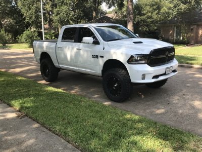

I took my stock antenna off, removed the ball on the end, cut it to my desired length, filed down the end, replaced ball on top and painted it black...freebie
Pics?

JB1-what’s your reception like with that mod??
How’d you cut it and what other steps you take?
Truck looks tough.

Reception is great, I haven't noticed any change.
To get the ball end off, use some pliers and kinda work it back and forth while using a twisting motion, it's a press fit. Then I just determined the length I wanted, placed it in a vise and cut it with a common hacksaw. Next I sanded it down with sandpaper. Next I used a file to remove any burrs where i cut it and kinda file it to a taper, during the filing I would test to see if the ball would go on the end. Keep filing until you can twist it on with force. Then I just spray painted it semi flat black. I like it because it looks unmodified and performs as oem

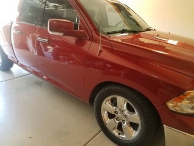

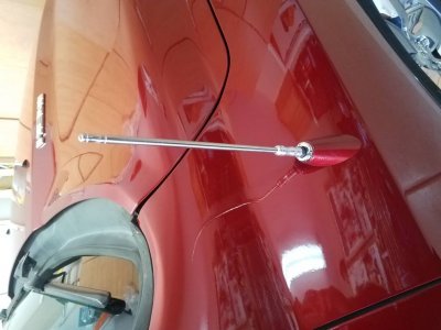

I had the base painted and went with an amazon stubby which causes the reception to suck. Use pandora most of the time so doesn't really matter.20180512_113640.jpeg20180512_113542.jpeg

^ Looks great!
I think the rubber whip stubby I bought off eBay is made of bubble gum and industrial waste. Literally got NO reception with the thing.
