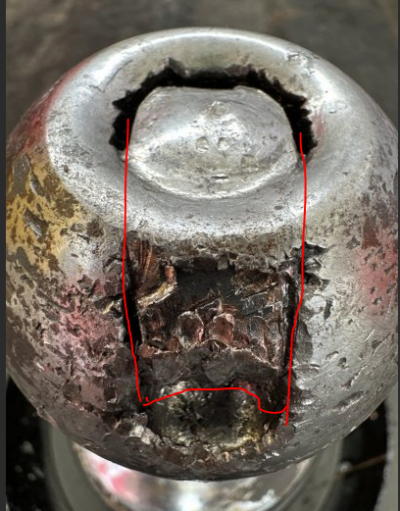

I just purchased a 2019 RAM Laramie 3500 DUALLY. There is a Curt 2-5/16 hitch ball in place and I can’t get it out. I have seeing many videos on how to remove them, however, the different with this one is the release mechanism (picture for reference). This release mechanism it’s not meant to move. There is not groove or space from top to bottom to move it up and to turn it to release the locking mechanism. I used WD-40 and cleaned around and have used many hand tools with no luck. Now, I’m new to this, maybe there is another method for me to do this that I’m not aware. Any recommendation will be appreciated.image.jpg

Go to local hitch shop, they will be quickly able to remove it, looks like you need a new ball anyhow. If there is no release mechanism it has to be bolted from the bottom, which I have honestly never seen.

The release mechanism is part of the ball, at least on the ones I have seen. That is why I prefer the B&W system that is operated by a bale.

I had a Curt ball like the one pictured. The video is correct, if you don't get that lever turned 90 degrees to the slot it will never come out. The metal stem connected to the lever has two cutouts that allow the steel balls to retract when it is in the correct removal position. I had a stuck one once. I was able to move the lever into the correct position then beat on the sides of the ball with a 5 LB dead blow hammer like a mad man. After about 10 minutes the balls finally retracted.
I took the new ball and pulled the little plastic cap off the bottom. I completely filled the inner workings with grease until it came out the top. Replaced the plastic cap and have not had a problem with the new ball. Well, other than getting a little greasy when I need to remove the ball to haul plywood and such.
Honestly, the best thing to do with any removable ball is to remove it and store it the truck when not in use. I keep mine wrapped in a dish towel under the rear seat. I also coat the socket in the bed with grease and use one of the rubber plugs Curt makes to keep the water out.
I watched the hitch shop guys remove one once. They cut off the ball at the neck. Drove the stem that locks the balls out through the bottom with a punch. Beat on it with a hammer. Welded a clevis plate to the top and pulled it out with an overhead hoist. They even had a protective blanket with a hole in it to protect the bed liner while welding. I guess they have done a few of these.

We ran into this issue once... the metal fused together making it impossible to lift the release lever. We were able to use a wheel cutter to re-create the space between the ball and the lever. The ball released once we made the cut, it was also stuck due to dirt and grime (MUD) so we had to hit it from the bottom up.

It's tough to do, but I've had to remove one like this before. I used an air hammer from underneath the bed and a ton of pb blaster and patience. It eventually broke loose and popped out.
