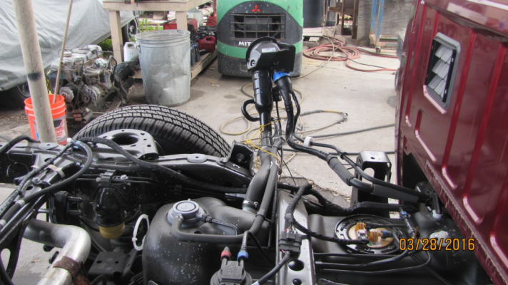

I had a 3/4" hose stuck in my filler neck
I have a few wooden dowels of different diameters
I shoved a dowel down along side of the hose, with a little maneuvering, i got the plastic hose out
If the wood rod had been made of slipperier plastic, it would have come out easier
IF you can't pull something out of the filler neck ..
Remove the drivers side rear tire
Then remove the plastic inner fender
disconnect the filler neck from the fuel tank
There should not be anything that would stop you from pushing the object out.
I have not researched the 5th Gen Ram filler necks though
this is my eco-diesel fill neck
