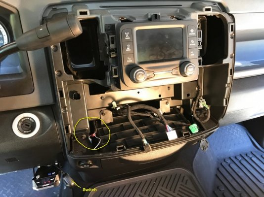

On my '15 Tradesman, I used the driver's side cig lighter as an ignition controlled power source for the switch when I installed some running lights. Had to take the trim around the radio off to get to it but it works great. Switch is permanently on and lights come on and off with ignition and I don't even think about it any more. Just a thought.
