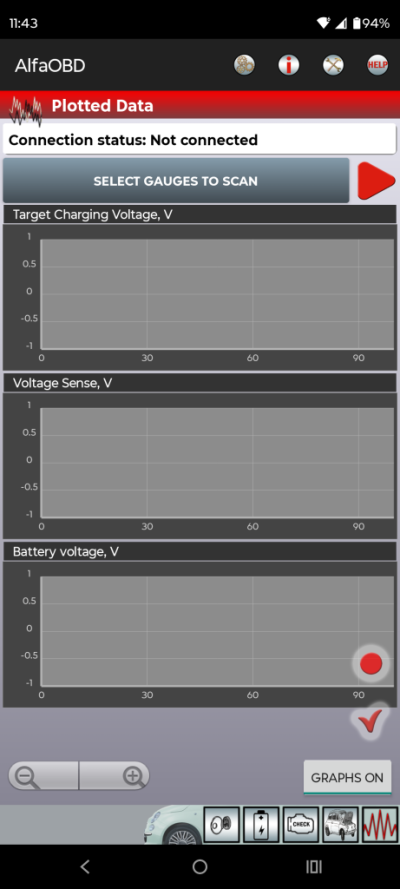

If you have a bidirectional scan tool or AlfaOBD you can look at live data that will show your system voltage, sensed voltage and the voltage the PCM is aiming for.
