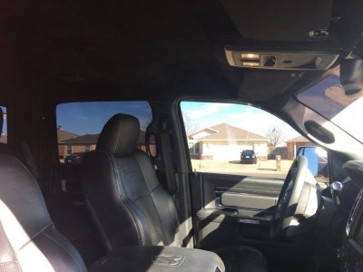

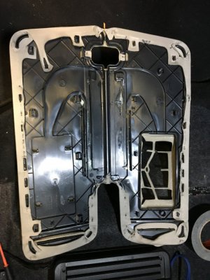

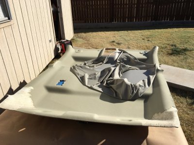

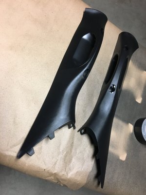

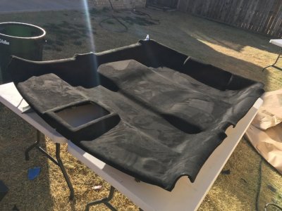

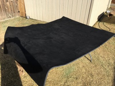

My name is Daniel a couple months ago, I had a week of vacation and decided to re-upholster my headliner lol, so here are the Progress pics. Decided to post since I hadn’t came across anything similar for our trucks. Lmk what you guys think!
Hardest part was removing the headliner from the truck lol.

Came out REAL nice!

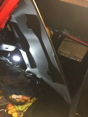

Were you able to get the headliner out without removing the windshield? Service manual says on anything but a regular cab, windshield needs to be removed to remove the headliner. Interested to know if (and how) you managed to do it without pulling the windshield first.

Yeah I was able to remove it through the rear driver side door. Removing it was actually the hardest part lol. I had to bend it a little bit, but no damage was done. In order to bend it, you’ll have to remove the overhead console and bracket that hold it in place. Here are some pics, right before I took it out (I had yet to remove the overhead console in these pics). Putting it back in was a breeze.
**Had to remove all seats and center console too btw.

Thanks for the info, glad to see it can come out without removing the windshield.
Bending it is my biggest worry....Ive done this job on my old Nissan Frontier but it was a smaller truck to start with and didnt have 4 doors (extended cab with just jump seats in back). It came out of the truck pretty easily. The actual re-upholster was pretty simple, and putting it back in was a bit easier than removing it since I remembered how I removed it and just did it in reverse.
