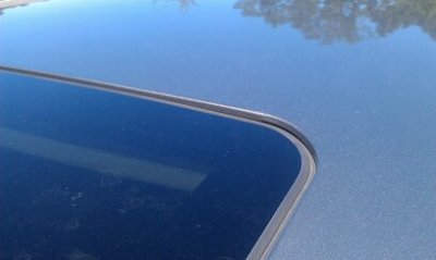

Well while in PC last week it rained a whole day straight. All the days prior I was riding around with the sunroof open and closing it at night, the day it rained I was getting major water leaking in from the roof. Upon investigation I found that the back of the sunroof seal wasn't pushing up to the top of the roof and causing it to have water leak by...... I have to push the glass up after closing to make it seal completely. Does anyone have any ideas why it won't seal up? I'll post pics ASAP

First 2 are with it closed by itself, last 2 are after I push the glass up to seal. Hopefully this helps someone help me lol

No it does have the tilt but when it opens it goes down then slides under the roof, I tried tilting it up then closing it down and it still doesn't seal right? Idk if I need to take it to the stealership or just deal with pushing it up after closing it?.... I heard its very expensive when it comes to sunroofs...

Is it something with the track not allowing it to push up at the end?

Idk it moves smoothly through its full motion, I guess ill have to pull the headliner down a bit and see if anything is in the way.

It's adjustable. You have to slide the fan/curtain like black piece out of the way and you'll see some torx screws. Should be 4. It's a pain in the ass but you'll have to adjust and check, adjust and check, etc. etc. etc... Very small adjustments make a pretty big difference in clearance. Did mine a while ago because of the same problem.

Ok awesome info! I'm glad someone had the same problem..... Well not that you had the problem but that you figured out how to fix it and could help lol Imma have to get out there and do it! Thanks man!

Mine has the adjustable torqs screws, but this thing just fixed itself! Idk wat is up with vehicles I have...... I just came out to make the adjustments and it went up all the and sealed.... Thanks for the help, ill just keep an eye on it to make sure it doesn't do this again lol

that's good that it sealed right, but I would think its going to happen again
